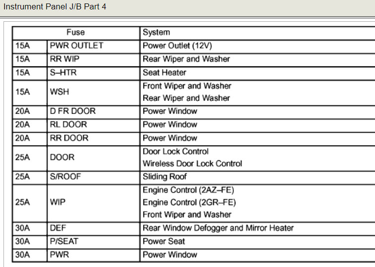

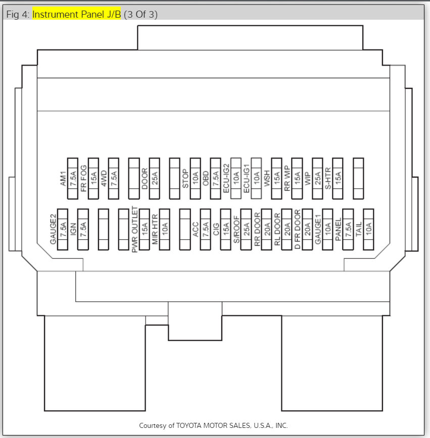

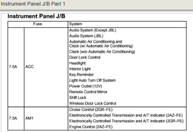

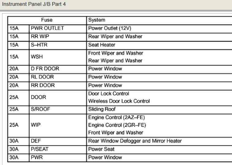

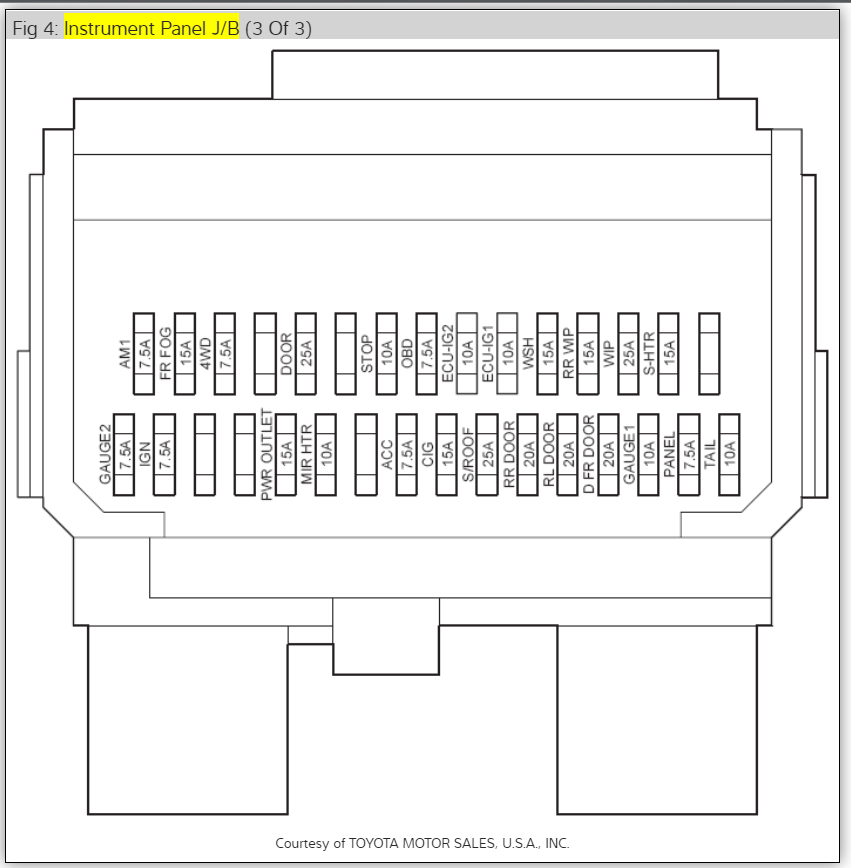

where is the cigarette lighter fuse on 2008 rav4?
Jul 27, 2008 at 9:22 AM
  • 75,992 POSTS
Merlin-Ive been looking for it on 2007's power distribution not there too. My way is to turn the key to run-its tedious and check every fuse you can find and test both ends on it till the test light don't lit up meaning the fuse is open replace it and see what happens-The ignition switch run and accy position powers the lighter-something has to give here
