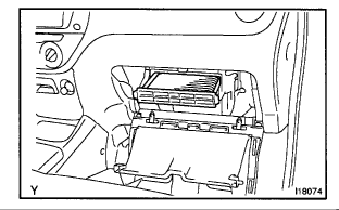

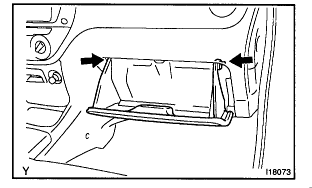

where is the cabin air filter and how do you change it.

AIR REFINER FILTER REPLACEMENT 1.REMOVE AIR REFINER FILTER
https://images.2carpros.com/forum/automotive_pictures/12900_cf_2.gif
a.Disconnect the glove compartment door. Push both sides inward one after another and pull out the glove compartment door.
https://images.2carpros.com/forum/automotive_pictures/12900_caf_4.gif
b.Pull out the filter case. c.Remove the air refiner filter from the filter case. 2.REINSTALL AIR REFINER FILTER a.Install the air refiner filter to the filter case. b.Install the filter case. c.Connect the glove compartment door. https://www.2carpros.com/kpages/auto_repair_manuals_alldata.htm
