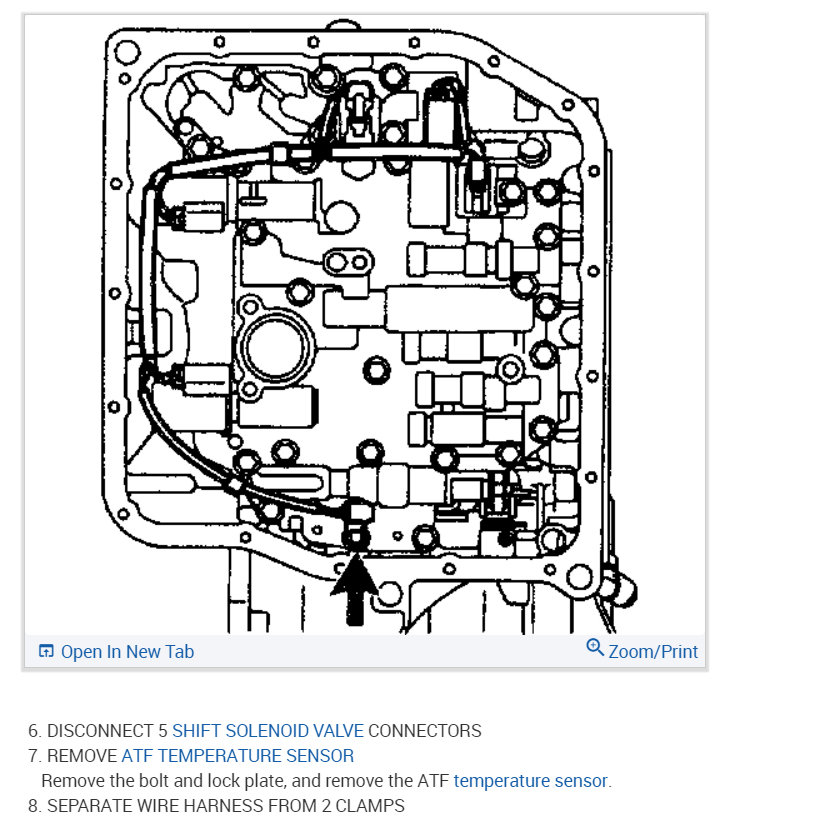

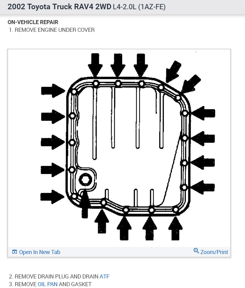

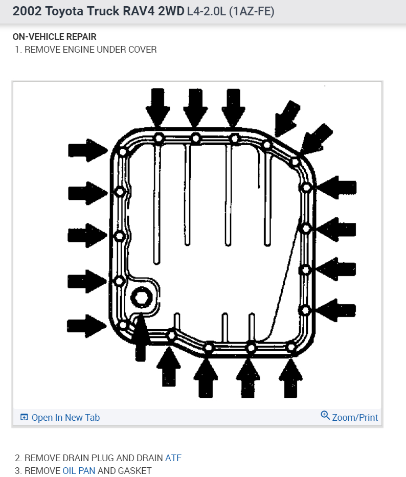

i need to replace the shift solenoid, do i have to remove the oil pan ?

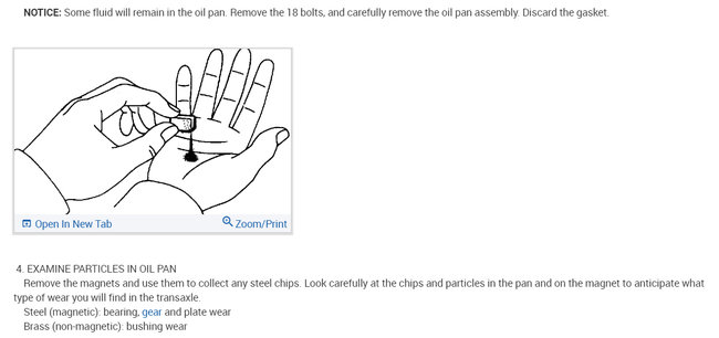

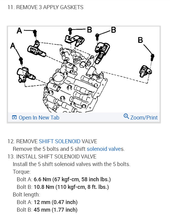

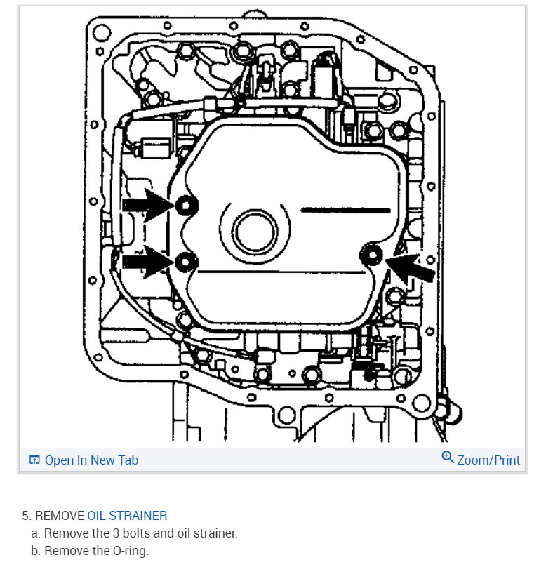

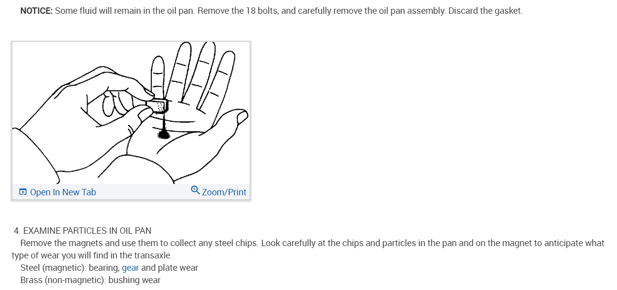

Yes, you do need to remove the pan. here is a guide to walk you through and diagrams below to show you how on your car below:
Images (Click to enlarge)

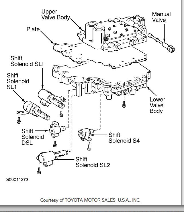

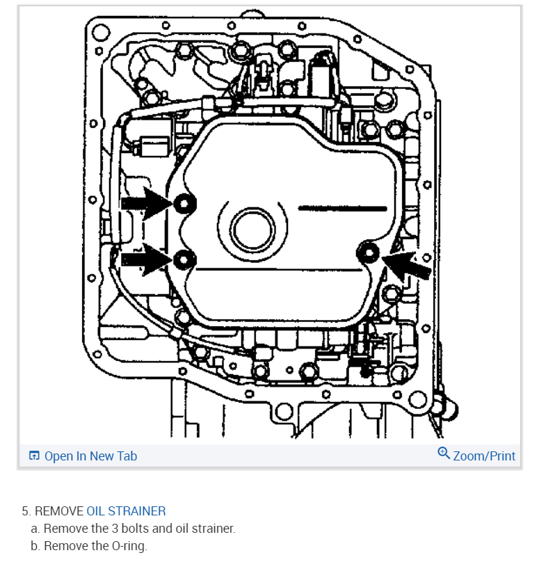

my rav4 manufacture year 2001 have shifting problem .i discover its shifting solenoid problem were it locate on valve body ? i thanks a lot .

what is the code it may not be the solenoid it may be something else in trans causing the problem. there are 5 of them
Image (Click to enlarge)
