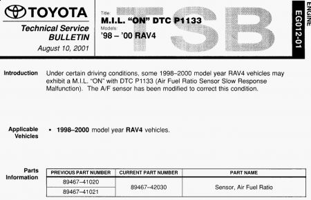

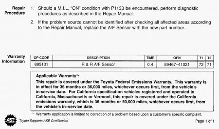

I am a technician working at an independent shop. This is my father’s Rav4 & it’s giving me fits. MIL would come on intermittently at first with loss of power and rough idle. Searched TSB’s. Found bulletin# EG012-01 for code P1133. Installed updated Air/Fuel ratio sensor,(new plugs, fuel filter,& air filter couple of weeks earlier).
All was well for about 6 months then MIL came back on, same codes & very intermittent so he kept driving. Meanwhile I was checking everything I could think of when I could get the rav4 away from him. It finally got too bad to drive, so I traded cars with him. I drove around with my scanner hooked up for 7 days before it finally acted up big time. A/F ratio voltage was stuck lean at about 3.8v to 4.0v, which Snap on’s scanner doesn’t list in freeze frame. The fuel trims were high.(See freeze frame data) Engine would barely idle, and even though sensor showed lean when I walked behind the vehicle there was black smoke was rolling out of the exhaust. At this point I pretty much ruled out a vacuum problem.
I re-ohmed & inspected the sensor to ECM wiring, so this time I tapped into AF+ and AF- at the sensor harness. AF+ was steady at 3.3V and AF- at 3.0V which is normal for this system. Even when engine would barely idle, these two voltages did not vary. In my mind that confirms the wiring from the ECM to the sensor is good. Called Toyota & got another A/F sensor. All was well for about 3 months & now the MIL is on again, same codes, same symptoms, but like last time, start out mild and I’m sure will continue to get worse. Am I missing something? Do I install a 3rd sensor? There have been 2 bulletins concerning code p1133, one in 1999 & the other in 2001. Both had updated A/F sensors. I am hesitant to go for the ECM because of the fact that a new sensor will go 3 to 6 months trouble-free, and then gradually gets worse almost to the point where it’s not drivable. Any help would be appreciated.

This is a known problem, A tech bulliten is out for 98-00 Rav4's Here it is:
https://images.2carpros.com/forum/automotive_pictures/62217_1133_1.jpg
https://images.2carpros.com/forum/automotive_pictures/62217_1133b_1.jpg
https://images.2carpros.com/forum/automotive_pictures/62217_afsens_1.jpg
