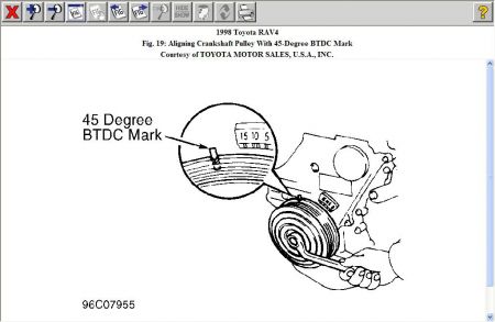

Four cylinder front wheel drive automatic.

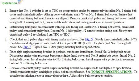

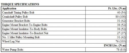

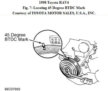

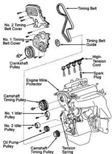

Trying to find out how to set the timing. Thought that I had the marks lined up. Also, trying to find out the diagram of how the belt runs. Thank you for your time.
Mar 18, 2009 at 8:02 PM
BLUELIGHTNIN6
  • 16,542 POSTS
Hello, Here is a link that shows all timing belts and camshaft marks: https://www.2carpros.com/diagrams/toyota/rav4/1998 More diagrams below.
https://images.2carpros.com/forum/automotive_pictures/261618_s_1.jpg
https://images.2carpros.com/forum/automotive_pictures/261618_Noname_340.jpg
https://images.2carpros.com/forum/automotive_pictures/261618_Noname2_95.jpg
https://images.2carpros.com/forum/automotive_pictures/261618_Noname3_49.jpg

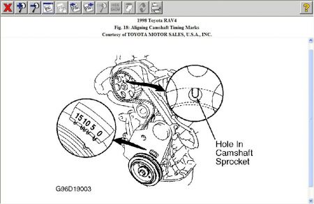

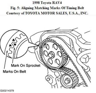

What are the timing belt marks?
Jul 20, 2018 at 2:01 PM (Merged)
  • 75,992 POSTS
See below.
https://images.2carpros.com/forum/automotive_pictures/12900_c1_12.jpg
https://images.2carpros.com/forum/automotive_pictures/12900_c2_9.jpg
