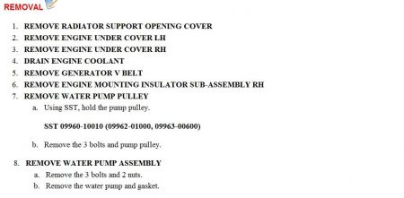

Replacing the water pump
Aug 30, 2010 at 8:27 AM
BLUELIGHTNIN6
Experienced Mechanic
16,542 POSTS
Aug 30, 2010 at 9:12 AM
