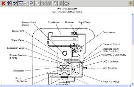

1996 Toyota Previa 4 cyl Two Wheel Drive Automatic
I need help in finding the heater fan. I have checked the fuses and all is ok I suspect that a mouse nest is in the fan compartment
Nov 1, 2008 at 4:10 AM
  • 75,988 POSTS
Front blower motor Its upfront -it has a air inlet housing center rear of front compartment
https://images.2carpros.com/forum/automotive_pictures/12900_blower_10.jpg
