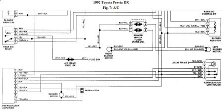

Hi
My blower motor was coming on intermittently - then just on med and high. One day smelled a burning electrical smell - ac blower no longer runs -
Now when I turn on blower and depress AC switch nothing happens - not even a green light by the AC button which used to always be thwere when the button was depressed.
When I depress the AC switch the engine can be heard goiong under load - the compressor runs and the rear AC blows cold (separate blower and blower switch for rear)
The front has nothing going on so I bought a switch out of the local upull a part as well as a blower resistor. I checked the blower by jumping it to the battery - front blower runs fine - swapped the blower switch and resistor but got no result - still no AC
Any clue? Are there other relays or fuses I could replace???
Thanks

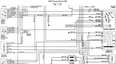

Hi
Check 40 amp Circuit Breaker #37 in instrument panel fuse box.

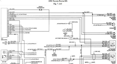

Hi jle11629, From the symptoms description of electrical burning smell, I believe it could be due to a burnt control unit. I have the schematic here and I would suggest checking the 2 amplifiers.
https://images.2carpros.com/forum/automotive_pictures/192750_ACWiring92Previa01a_1.jpg
https://images.2carpros.com/forum/automotive_pictures/192750_ACWiring92Previa01b_1.jpg
https://images.2carpros.com/forum/automotive_pictures/192750_ACWiring92Previa01c_1.jpg
