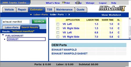

need a new oxygen sensor and manifold. they say the Oxygen sensor is rusted in the manifold. how much should this costs for parts and labor on a 2000 toyota tundra

What do have a V6 or V8?
What do you wanna do-replace the oxygen sensor or both. If its both its gonna cost. Just the manifold itself is $275.00 thats not counting the labor involved that could range from $70.00 to $125.00
If its me I'll have them remove the O2 sensor and replace it-Rusted or Not.

Subject: 2000 toyota tundra its a v8..they said to get the O2 sensor out they would have to ruin the manifold..they said the two are rusted together..they are going to replace the manifold and the sensor...how much labor should that be? See below-Labor rate varies with location could be $70.00 to $125.00 an hour not counting parts and extras.
https://images.2carpros.com/forum/automotive_pictures/12900_manifold_1.jpg
