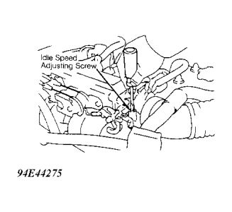

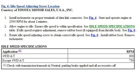

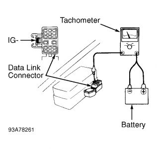

The idle on my 94 toyota pick up runs really low(500 or less) after engine reaches normal running temp. What can I do about it?
Friday, December 5th, 2008 AT 12:45 AM
MHPAUTOS
MECHANIC
31,937 POSTS
Hi thetre'
Check the tune and re set the idle as per instructions.
