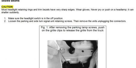

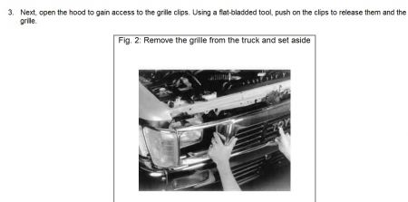

I have seal headlights. I tried removing grill but can't seem to remove it. can you provide the procedure for replacement of headlights for my pickup. Do I replace them from inside engine or ourside?

I found this info.
https://images.2carpros.com/forum/automotive_pictures/170934_sealed_beams_1_1.jpg
https://images.2carpros.com/forum/automotive_pictures/170934_sealed_beam_2_1.jpg
