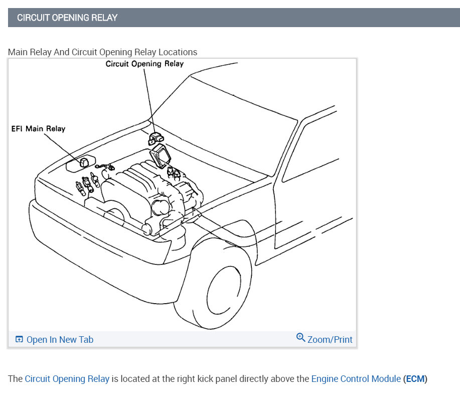

where is the fuel pump relay unit located?
May 31, 2009 at 3:31 PM
  • 75,992 POSTS
What you're looking for is the circuit opening relay. Here is a guide to help you test it and the location in the diagrams below.

Where is the fuel pump relay located?
Mar 12, 2019 at 4:46 AM (Merged)
BLUELIGHTNIN6
  • 16,542 POSTS
The fuel pump is ran through the EFI circuit opening relay as well as the EFI Main Relay. The EFI circuit opening relay is located behind the right side of the dash, above the ECU. The main relay is located in the fuse / relay block #2 (on the front right corner of engine compartment).

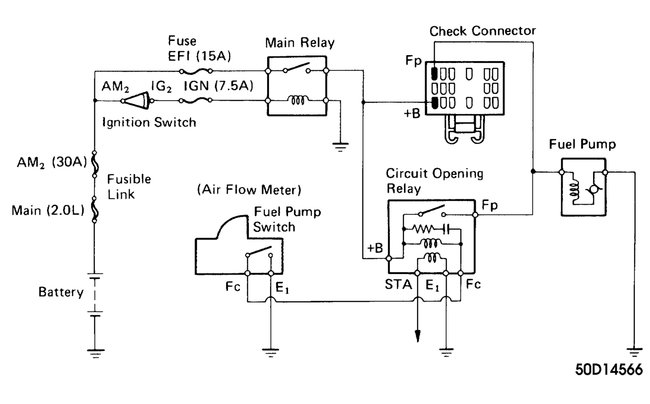

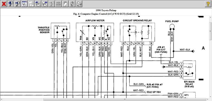

Okay, we have no power to the circuit opening relay, no power to the fuel pump and no power to mass air. The coil is firing, spark plugs firing and fuses are good. What could the problem be? Could it be whats on top the coil? Thanks for the help:)
  • 55,423 POSTS
Here is a wiring diagram for the circuit, it looks like the fuseable links in the system are blown if the EFI fuses are all good

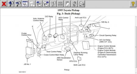

Where is the location of my fuel pump relay? I have looked at the fuses under my dash but I don't see that one?
Oct 1, 2019 at 11:15 AM (Merged)
  • 75,992 POSTS
Its the circuit opening relay that powers up the fuel pump

My truck dies out after being warmed up. I replaced everything (plugs, wires, fuel/air filter, and oil). On another note, is there a fuel pump relay switch and where is it located. Any help will be gladly appreciated. thanks.
Oct 2, 2019 at 3:17 AM (Merged)
  • 75,992 POSTS
The circuit opening relay acts as a fuel pump relay see below
https://images.2carpros.com/forum/automotive_pictures/12900_cor_5.jpg
