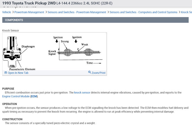

i took my toyota pickup for an oil change and the engine light was on, the toyota dealer told me it was the knock sensor. i order the sensor and installed it myself and after i press i press the gas it lights up again. i also here a small knocking sound please tell me what to do?

The knock sensor is very delicate if you over tighten it it will break, here is the location of the sensor and how to replace it also they had problem with the wiring connector so you might want to ge a new one.
The Knock Sensor is located on the right side of the engine block above the starter.
Toyota does not specify a torque value for the knock sensor. So just snug will work.
