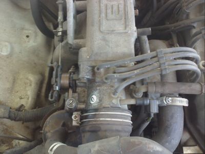

GFOURTH
Here is a picture of the intake. Is the idle air screw the flush slotted head on the left of the intake, just above the hose clamp screw? Thank you again for helping
https://images.2carpros.com/forum/automotive_pictures/187228_yota_intake_1.jpg
May 13, 2008 at 9:34 AM
2CARPRO JACK
  • 11,533 POSTS
Yes. Turn it in half turn at a time, keeping track so you can put it back if necessary.

RACERBOY53
So after searching online for this problem this was my answer to my similar problem. Towards the rear of the engine compartment there is a gold colored valve that has some letters and vacuum hoses coming off it. There was one hose that was disconnected and I found that the idle adjusting screw was backed out completely (this screw is on the left side of the throttle body before the intake manifold). I screwed that back in and adjusted the idle accordingly. All fixed.
What was happening: I had an abnormal high idle when cold then as the temp come up to normal the idle would fluctuate up and down when the brake was depressed. This action of sporadic idling is caused from the ECM detecting this high idle condition and trying to compensate with the auto lower idle circuit that kicks in when you depress the brake. I hope this helps as it resolved my problem without replacing any parts. Thanks to all that have posted information for this problem it sure helped.
