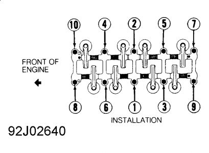

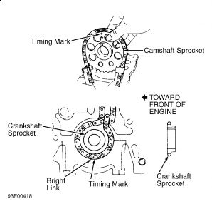

please send me the timing marks location for reinstallation of the timing chain as well as the torque and tightening sequence for the cylinder head. this is a 1992 toyota pick up 4 cyl 22 RE motor 2.4L.

Hope this helps
https://images.2carpros.com/forum/automotive_pictures/198357_Graphic_186.jpg
https://images.2carpros.com/forum/automotive_pictures/198357_Grafic_3_60.jpg
Torque 58 ft. lbs.
