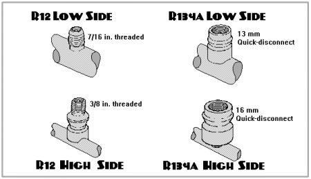

Which intake is the low pressure and which is the high pressure? I see one with a red cap and one with a black cap.
Sep 24, 2009 at 11:03 PM
  • 75,992 POSTS
Is it converted over to R134a system https://www.2carpros.com/articles/air-conditioner-how-to-add-freon
https://images.2carpros.com/forum/automotive_pictures/12900_ac_service_fittings_19.jpg
