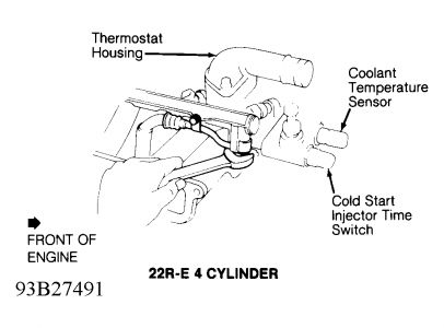

We checked the diagnostic code from the check engine light and it said engine coolant temperature sensor was bad. Okay, now we need to know where the sensor is located in engine compartment.

Hi there, See picture for location of CTS. Mark (mhpautos)
