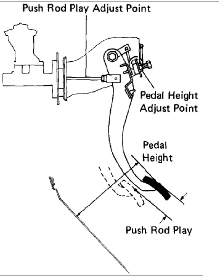

Engine Mechanical problem 6 cyl Four Wheel Drive Manual 275000 miles
Clutch was not fully disengaging. Found I had a leaking clutch hydraulics; fluid level was low. Filled and bleed hydrualics. No change. Replaced Main and Slave. Adjusted under dash to max on main cylinder arm. Where is adjuster on oor near slave? I see nothing to adjust on slave. Clutch still does not fully disengage. Have to start car in gear. Can shift when running.
Sep 6, 2010 at 6:46 AM
  • 55,433 POSTS

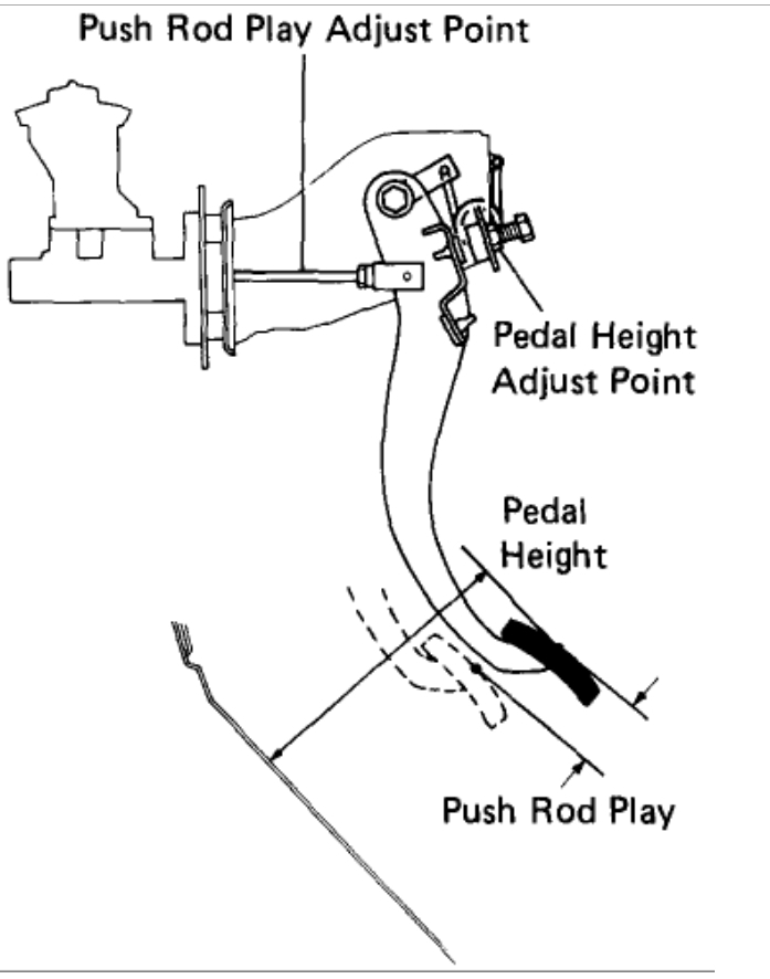

There is an adjustment but it is up at the clutch pedal. Loosen the jam nut and wind the push rod out a turn or so then recheck the pedal travel.
