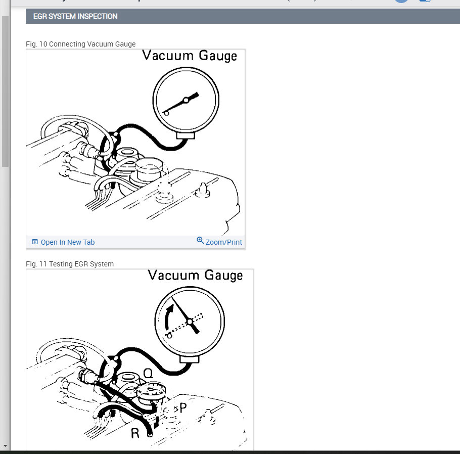

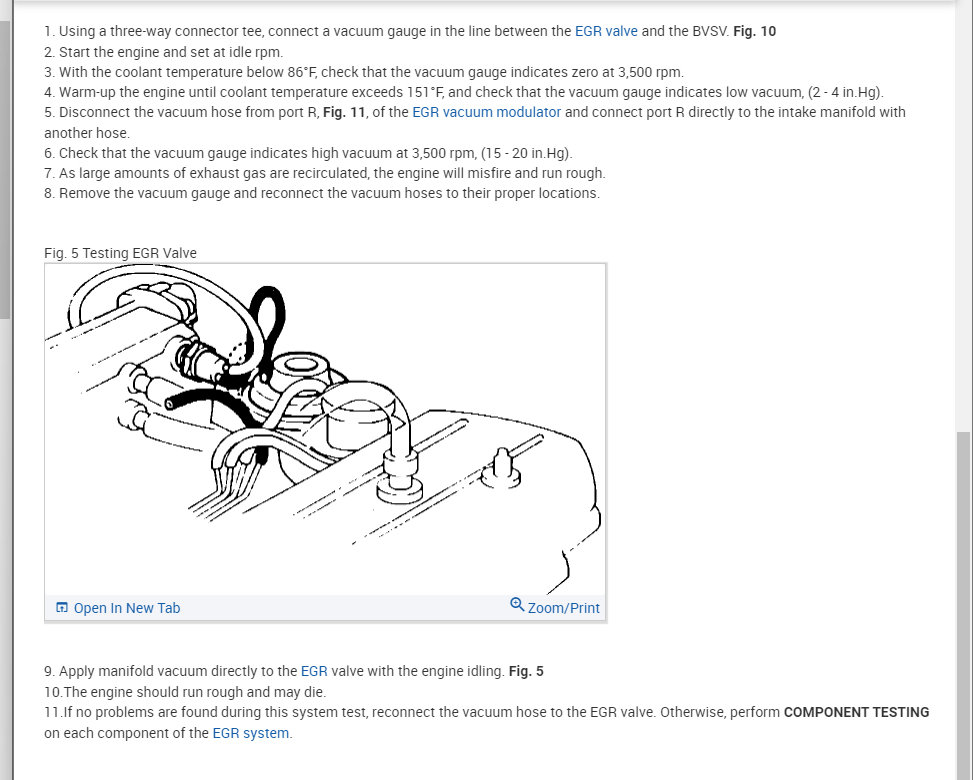

How do you tell if a EGR valve is clogged up? and how do you clean it out if it is clogged up?
Mar 11, 2010 at 1:55 AM
There are a couple ways to check this, but the first way is to check for codes.
Here is a guide that will help with this:
https://www.2carpros.com/articles/toyota-trouble-code-definitions-and-code-gathering-method-1990-1995
Also, here is a guide that will help with testing the valve itself which contains really good info:
https://youtu.be/DqUCbbKdWf4
However, the definitive way is to use the testing that we are attaching below.
Please run through this info and let me know what you find. Thanks
