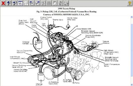

I need vacuum diagrams for this modle truck,federal and canada...it is a 22r/not e,is there anywhere I can get this online where I dont have to pay an arm and a leg?...thanks,Maggie
Sep 20, 2008 at 7:54 AM
  • 75,992 POSTS
You can download it for a cheaper price-see repair manual below click on it This is the best I could do otherwise it'll be unreadable
