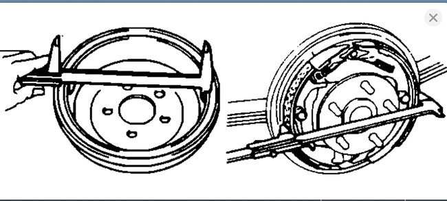

The noise you hear is commonly caused by a lack of lubrication between the shoe and backing place (where the shoe touches the backing plate).
Also, I want you to try one other thing. Adjust the brakes until you feel a drag. Then, get in the vehicle and apply the brakes several times to center the shoes and readjust. Between the brake drum and brake shoe, there should be .024" which is minimal. See pic 1

Just sending a check-in note. I've been busy and although I've been out working on the brakes my truck is a 1-ton dually and has a free floating rear axle. Taking the drums off is a PITA and requires me to remove the axle on each side - I'm getting there. Between that and attempting to back off the shoes by way of the star wheel (which I'm terrible at and always have a very difficult time finding an releasing the arm that holds the star wheel in place) it's taking me a minute. I'll send another update soon.

Alright, I finally had time to remove the axle shafts, bearings and lock nuts so I could get the drums off of the rear. I turned the star wheel completely and started measuring as best I could to get close to the right amount of tightness. I don’t have a brake caliper tool but worked at it. I'm never entirely sure how much drag there is supposed to be. I’ve watched some more videos but it’s hard to know how “easy” it should be to be able to turn each wheel by hand with the drum installed. I’ve been listening for shoe drag and it seems okay.
I got in the truck and pumped the brake pedal several times for each drum/shoe adjustment. Before beginning the shoe adjustment I loosened the parking brake nut on the cable so that I could go back and readjust that as well once the shoes and drums are done. I also pulled up on the parking brake a few times after each adjustment. Last thing I did was turn the engine on and pump the brake to see if the pedal feels and different.
Should I keep tightening the shoes? The wheels are still pretty easy to turn and I can do it with one hand. The other thing I’ve observed is that the driver’s side drum gets harder to turn then easier to turn while spinning the drum. The drums and shoes are all new. Is this something to be concerned about?

Does the emergency brake seem to work good? if so the shoe adjustment is correct. How does the brake pedal feel? Can you please shoot a quick video with your phone so we can see what's going on? that would be great. You can upload it here with your response.
