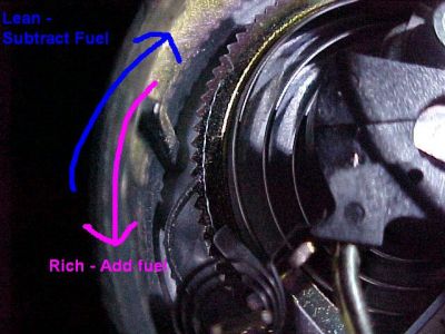

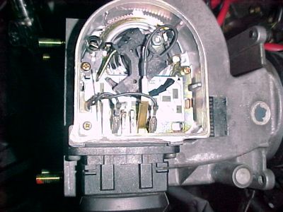

It would take me 6 pages to fully explain why, but I think what is happening is that a huge amount of gas is being injected into all cylinders, making it seem like it is down a few cylinders, and running like crap. I think the problem lies with the Vane Air Flow Meter which is integrated into the air box lid. It has a sensitive electronic circuit board on top that is covered by a metal plate that is glued in place. It also has a 8 pronged electronic plug that clips to it. The part number is "22250-65101". I did a web search on this part number and found some interesting stuff. If these sensitive electronics are a little messed up, it can cause major dumping of fuel, which would explain the huge amount of black smoke from the exhaust. I am wondering if some water got into the plug and maybe shorted out something on the circuit board? This the only thing I can think of now. Do you know anything about this Air Flow Meter, which is I believe a early version of a Mass Air Flow Sensor? Thoughts? Man this is a tough one !!!

You won't believe what I figured out had to be done to fix this issue. See the 3 pics of the Air Flow Meter I inserted? I had to pry off the glued on cover, and rotate the geared wheel clockwise almost a half turn, and that solved everything. It is running very smoothly, no more black smoke. I started a few clicks at a time, then drove the truck. I continued until it ran the best. A web page I saw indicated moving it 5-7 clicks, but mine took probably 30-40 clicks. What caused this is beyond me (Thoughts?), but it is definitely this AFM that caused the dumping of excessive fuel, causing the issue. The last couple times I drove it in this condition, I could practically see the gas guage needle dropping. Man this was a tough one to solve. Have you or any of your colleagues ever experienced an issue like this. I am known for having unique problems no one has ever seen before.

The water could have caused somthing to shrink when it splashed onto the engine and this can caused the AFM to go out of calibration. Under normal circumstances, this part should be replaced as it is a sealed unit and no repairs are recommended.
Calibrations are from factory and by trial and error you managed to get it correct. Well done.
