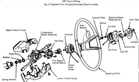

my turn lights and emergency lights are not working anymore. they were a couple days ago.[img:ee2a2a07fe]http://www.2carpros.com/forum/automotive_pictures/367004_3ka3mb3o7ZZZZZZZZZ95t5f852a07f97517bf_1.jpg[/img:ee2a2a07fe]

Not working meaning not flashing or not lighting at all?

SERVICE WRITER
  • 9,123 POSTS
Okay...So they do nothing when they are turned on.
Check the fuse first.
IF good, Rapidly move the hazard switch and see if they react. That can flush out a bad switch sometimes.

SERVICE WRITER
  • 9,123 POSTS
What I meant was push in the hazard switch in and out rapidly. ANyways, the common denominator here is the combination switch. IF power is going to it but not coming out, you'll need the combination switch that incorporates both the hazard and turn signal switchs into one component.

ELREDEYE
I had the same problem on my '87. I replaced the flasher right below the fuse box.
