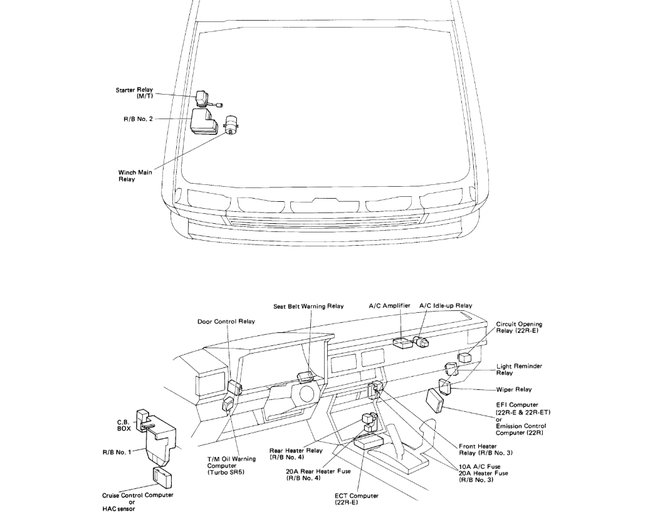

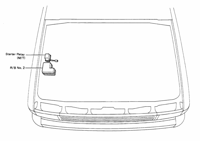

I need to know the actual location of the starter relay for this particular model vehicle. It is not specific in the vehicle manual I have. Can you clarify exactly where it is located?

The starter relay is on the front right side of the fender under the hood here is a guide to help you test it with the location in a diagrams below.
Check out the diagrams (Below). Please let us know if you need anything else to get the problem fixed. Cheers,

when i turn the key, it clicks and does not turn over. i have replaced battery and connections are good. checked grounds, new starter, distributor cap. truck runs good when pop starting down a hill. cant get it to crank with key. Where is the starter relay located?

You don't have a starter relay- check and test the neutral start switch and the ignition switch

Where is the starter relay located on a 1987 toyota pickup 4X4 2.4L and what does it look like?

The starter relay is located under the hood on the passenger's side. Here is a guide to help you test it.
