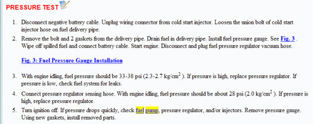

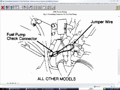

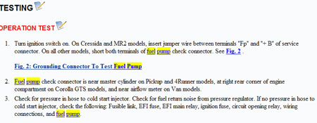

I Own A Toyota truck when i bought it it needed a fuel pump i changed the fuel pump but i have a problem the is not getting any power and i checked the wiring and power is not going to the fuel pump and i don't know where the relay fuse is at.

Here's what to check...
https://images.2carpros.com/forum/automotive_pictures/62217_FPa_1.jpg
https://images.2carpros.com/forum/automotive_pictures/62217_FPb_1.jpg
https://images.2carpros.com/forum/automotive_pictures/62217_FPc_1.jpg
