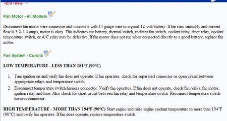

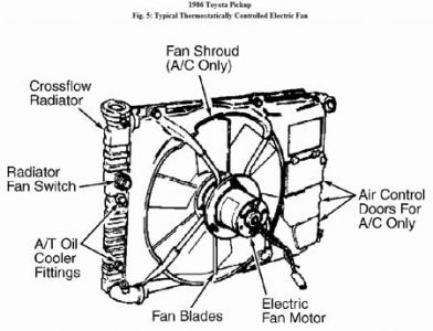

toyota heat indicator rises ,i let pressure of thradiator cap water begins to circulate and engine begins to cool. some times i can just let it idle and th thermostat will open and it cools properly . i have replaced the radiator cap and the thermostat. the waterpump is working. sometimes water will flow back into the over flow tube. ???

Sounds like a cooling fan or thermoswitch problem...
https://images.2carpros.com/forum/automotive_pictures/62217_Fan_3.jpg
https://images.2carpros.com/forum/automotive_pictures/62217_Fan1_1.jpg
https://images.2carpros.com/forum/automotive_pictures/62217_Fan2_1.jpg
