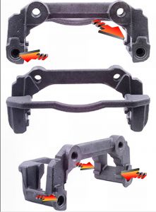

I have a 1996 Toyota pasao with about 128k.
I just changed my break pads because they suddenly started having a scraping sound. When I did I found that only one pad was worn. (I still replaced all four front pads). The other three pads look just fine with more than .25 inch of pad left. Is this a rotor or a caliper issue? How should I stop this from happening?

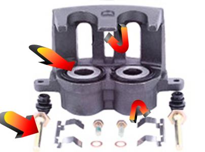

Appearantly the pistons went back in okay. This is very likely from lack of lubrication to the slide pins and where the pads rub against the cailiper bracket. These need to have thae tin hardware pu=lled off , wire wheel the bracket, the tins clips, the pins cleaned and lube. Lube anything that is touching with high temp caliper grease.
https://images.2carpros.com/forum/automotive_pictures/30961_caliper_lube_2.jpg
https://images.2carpros.com/forum/automotive_pictures/30961_caliper_lubeareas_2.jpg
https://images.2carpros.com/forum/automotive_pictures/30961_caliper_lubeareasbrack_2.jpg
This probably isn't the same as yours exactly, but you get the idea. I only like the above product.
