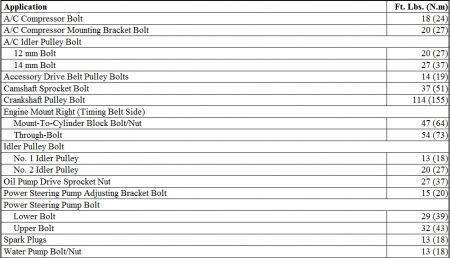

Anybody know the torque specs for the timing belt tensioner and for the crank pulley?

https://images.2carpros.com/forum/automotive_pictures/261618_Noname_2560.jpg

Thank you, that's exactly what I was looking for.

34 pounds for the timing belt tensioner bolts.
