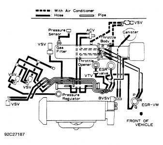

Where is the ERG Valve located on a 1992 Toyota Paseo. Having a tough time locating this part on the engine. Does this car even have a ERG Valve.

If it is a California car it does for sure, other applications may vary. Here is avacuum diagram that shows pretty much where it should be.
