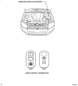

OK if the keyless function is not working it may be that it isn't triggered to work. As you said it may be disabled. Now the only way to enable it if that is the case is to scan it and get into the body control module and turn on the option. Now I did find that the there a tranmitter on the truck under the hood see pic included. Now as for the Fob programming it looks like it was not correct I found something different with some deeper digging. The other procedure that I sent is if you have the transmitter code so you manually program it but you don't have that code. So here is another way to do it without the code, however you need a techstream display to do this so you may need to take to the dealer the first time. First use the pic below to see if your truck was set up for keyless entry, if this part (wireless door lock buzzer) is missing then you don't have a keyless option.
https://images.2carpros.com/forum/automotive_pictures/249564_Graphic_174.jpg
