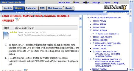

I bought this 2006 Toyota Matrix a month ago. All things that are done at thirty thousand miles were done, as the car had 29,500 miles when I bought it. How do I turn the maintenance required light off? I do most of my repairs anyway. Thank you so much, George
