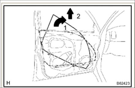

I recently took my Toyota Matrix in for a recall. It was to replace the window bolt. Before taking it in, my automatic lock/keyless entry was not working, BUT, I could still lock my car by inserting the key into the lock or manually flipping the switch. When I picked the car up, I could no longer lock the door at all. The door switch won't flip when you try to turn it manually.
I took it back to Toyota and explained that I thought they had jammed something when they replaced the bolt. They claim that the problem is the door lock actuator and that in order to fix the lock, it has to be replaced.
If the door lock actuator is broken, can you not manually flip the switch to lock your car? Does their explanation make sense or are they taking me for a ride?

Well, it does seem odd doesn’t it? Working with the key and now you can not. I hate to say, I worked one of these last week and the person kind of had the same issue only they would almost break the key off trying to unlock it…..finally it wouldn’t even do that.
If the actuator is at this moment dead….then that is possible. Again, it’s just odd that it happened then….I do agree and with the reputation of some dealers, I can see your fear and totally know your frustration. I am sorry.
The only way to know for sure is to remove the door panel and check to see if what’s going on in there. When you put your key in, will it turn at all? When you do it manually, you said it won’t flip…..does it seem like it’s jammed or stuck?
Again, it is odd…..but…..possible…..I believe I have the directions on removing the door panel…want to give it try and replace the lock actuator? Auto Zone has them for about $93.00?

Instructions on how to remove the door panel would be great. We're going to give it a try ourselves. When I insert the key now, I can't move the lock. It's as if it's stuck. Toyota was going to charge me $400.00. I have a friend who is far more mechanically astute than I, so we're going to give it a shot Friday. But instructions on the door panel would be great if you have them. Thanks for your help! This is a great service.

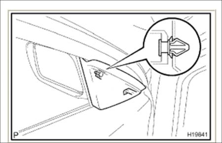

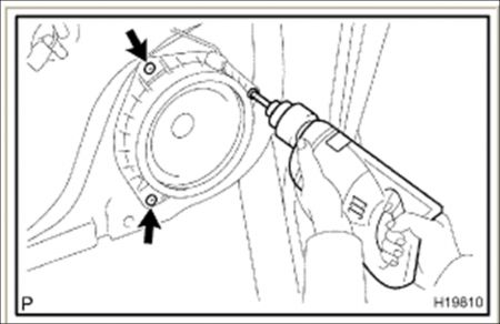

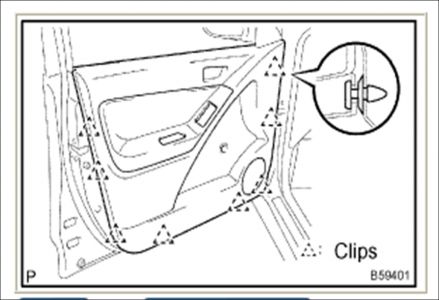

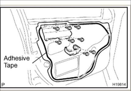

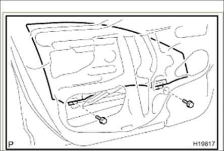

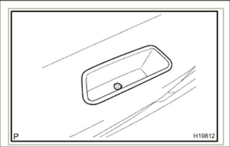

Hello - Good on you for attempting this. Just a couple of things if I may. First, allow yourself plenty of time. Go slow and keep track of the order of things. The information I am attaching shows a complete over hall of the door. You shouldn't have to do all of that. Just remove what you need to so do not do all of the steps.......just to the part to where you can do the lock. I just attached it all for your reference. Be careful.....many of these parts are sharp. Note the tools and my advice is if you notice in step 4b, purchase new clips.....many times they brake and you can not properly put the door panel back on. I normally just replace them all. If you notice - to work on that bolt for the glass you would stop at step 14.....so as you see they don't get to the lock. Not sure if you have manual windows or electric.....manual - the handle is held on with a clip....look at the last pic..... Please review all of this and if you have any questions please let me know and I will do what I can. Good luck! Thanks for the donation Please let us know if what the final fix was for your car so we can better assist others. Thanks! Find a car repair manual for your car repair questions. OVERHAUL HINT: The installation procedures are the removal procedures in reverse order. However, only installation procedures requiring additional information are included. Use the same procedures for the RH side and LH side. The procedures listed below are for the LH side. A bolt without a torque specification is shown in the standard bolt chart.
https://images.2carpros.com/forum/automotive_pictures/248015_Picture3_10.jpg

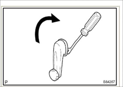

REMOVE FRONT DOOR WINDOW REGULATOR HANDLE ASSEMBLY (W/O POWER WINDOW) Insert a clip remover between the plate and trim. Maintain the position in (a) and turn the handle as shown in the illustration to remove the handle.
https://images.2carpros.com/forum/automotive_pictures/248015_Picture4_9.jpg

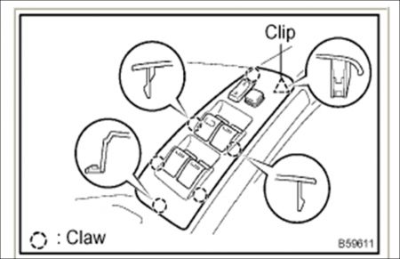

REMOVE POWER WINDOW REGULATOR MASTER SWITCH ASSEMBLY (W/ POWER WINDOW) Using a screwdriver, disengage the clip, 6 claws, remove the power window regulator master switch from the trim board. HINT: Tape the screwdriver tip before use. Disconnect the master switch connector. Remove the 3 screws and base panel from the master switch. REMOVE FRONT ARMREST BASE PANEL UPPER LH (W/O POWER WINDOW) w/o Power door lock: Remove the front armrest base panel upper. Using a screwdriver, remove the front armrest base panel upper from the trim board. HINT: Tape the screwdriver tip before use. w/ Power door lock: Remove the front armrest base panel upper. Using a screwdriver, remove the front armrest base panel upper from the trim board. HINT: Tape the screwdriver tip before use. Disconnect the door lock switch connector. Remove the door lock switch from the base panel.
https://images.2carpros.com/forum/automotive_pictures/248015_Picture6_7.jpg

REMOVE FRONT DOOR TRIM BOARD SUB-ASSEMBLY LH Remove the screw. Using a screwdriver, disengage the 7 clips and then pull the trim board upward to remove it. HINT: Tape the screwdriver tip before use.

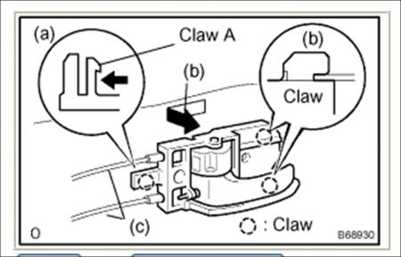

REMOVE FRONT DOOR INSIDE HANDLE SUB-ASSEMBLY LH Using a screwdriver, disengage claw A. HINT: Tape the screwdriver tip before use. Move the inside handle in the direction indicated by the arrow mark in the illustration. This will release the claw and allow removal of the inside handle. Disconnect the 2 cables from the inside handle.

REMOVE FRONT DOOR SERVICE HOLE COVER LH Remove the 2 screws and bracket. Remove the service hole cover. NOTE: Remove the remaining tape on the body. Remove the 2 screws and reinforcement. REMOVE OUTER REAR VIEW MIRROR ASSEMBLY LH REMOVE FRONT DOOR BELT MOULDING ASSEMBLY LH

REMOVE FRONT NO.1 SPEAKER ASSEMBLY Disconnect the speaker connector. Using a drill of less than Dia. 4 mm (0.16 in.) , drill out the 3 rivet heads and remove the speaker. NOTE: Be sure to gently place the drill perpendicular to the rivet to prevent the rivet hole and the drill itself from being damaged. Be careful with the cut rivet, because it is hot. Even if the flange is taken off, continue drilling and push out the remaining fragments with the drill. Using a vacuum cleaner, remove the drilled rivet and dust from the inside of the door.

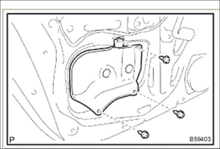

REMOVE FRONT DOOR INSIDE PANEL PLATE LH Remove the 3 screws and inside panel plate.
https://images.2carpros.com/forum/automotive_pictures/248015_Picture12_3.jpg

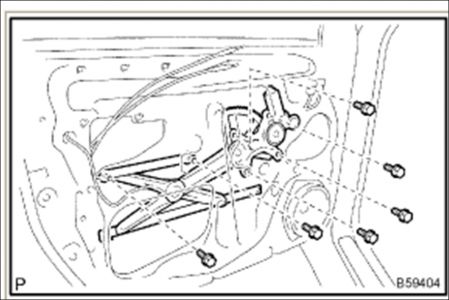

REMOVE FRONT DOOR WINDOW REGULATOR SUB-ASSEMBLY LH (W/ POWER WINDOW) Disconnect the window regulator connector. Loosen the 6 bolts. NOTE: Be careful when removing the bolts as the window regulator may fall and become damaged. Remove the 6 bolts and front door window regulator. HINT: Remove the window regulator through the service hole.
https://images.2carpros.com/forum/automotive_pictures/248015_Picture15_3.jpg

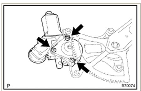

REMOVE POWER WINDOW REGULATOR MOTOR ASSEMBLY LH (W/ POWER WINDOW) Place matchmarks on the window regulator motor bracket and regulator gear. Remove the 3 screws and motor.
https://images.2carpros.com/forum/automotive_pictures/248015_17_3.gif

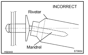

NOTE: Do not prize the riveter. The riveter will be damaged and the mandrel will bend.
https://images.2carpros.com/forum/automotive_pictures/248015_36anote_1.gif
Do not tilt the riveter when fastening the rivet to the speaker as this will cause the rivet to be loose. Do not have any space between the rivet head and the speaker. The rivet head must be completely flat against the speaker.
https://images.2carpros.com/forum/automotive_pictures/248015_36anote2_1.gif
