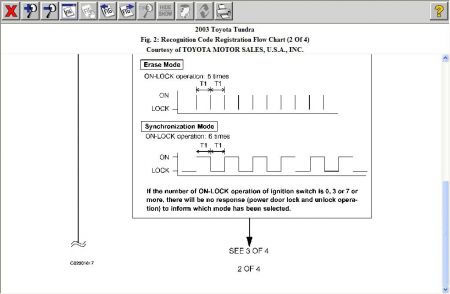

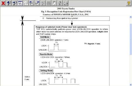

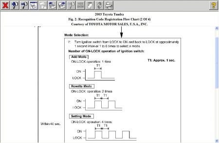

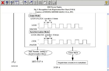

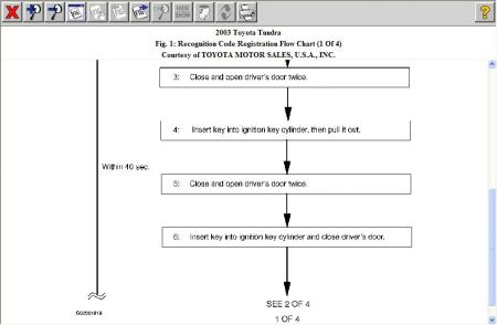

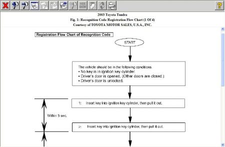

To start i do not have a remote for my 2000 ToyotaTundra--I parked next to a New Model Camry and didnot lock my truck, when I returned I belive the Camry engaged the security on my truck, my doors were locked and the engine imobilzer was engaged- We disconnected the engine emobilizer got it started but the alarm will not disconnect without the remote. How do I shut it off??
Oct 18, 2008 at 5:28 AM
KHLOW2008
  • 41,814 POSTS
Hi loopiiii, Thank you for the donation and sorry for the delay in answering. I could not find any information regarding the alarm for 2000 but managed to get a 2003 system. When transmitters are lost, it is used to erase the alarm memory.
