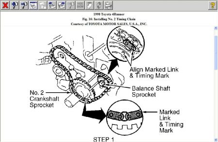

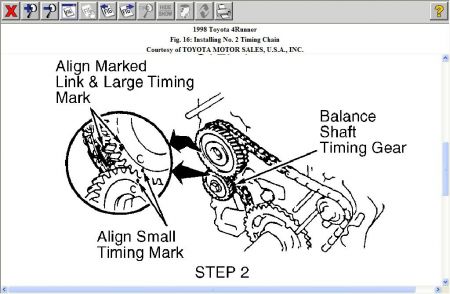

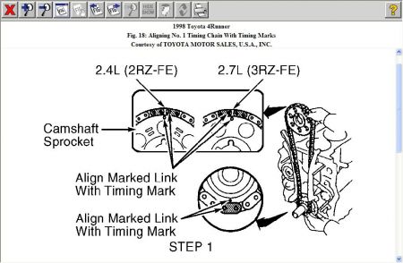

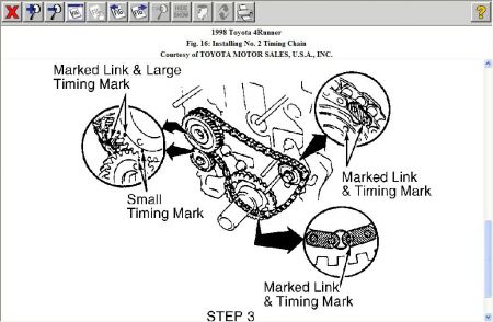

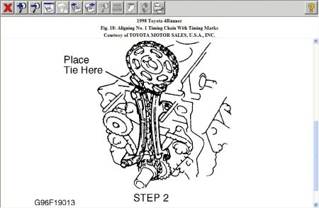

I am chaning timing chain on a 1998 toyota tacoma 4X4. It has a front and back timing chain. What is the correct timing for both chain? I put both chains on and it was running great that same night but the next day it was missing and backfiring

Hi dan987, Hope I got the correct diagrams.
