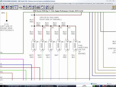

Hello just came back from Hawaii and got a noid light set from Kragen auto. for $36.00.
Tested all 6 injectors harness. All but one are pulsating # 2 injector stays on constantly.
where and what should I check next????
Thank
Albert
Feb 24, 2008 at 12:55 AM
MERLIN2021
  • 17,250 POSTS
There are two ways injectors are powerd, power always on, pulsed by neg(-) or pulsed by pos(+)...I believe yours is controlled by the ground, Trace the White wire of the #2 injector, run a continuity test to the block, if no cont, trace wire for a break....

Checked # 2 injector wires white and black/red from connector to ecm and has continuity on both wire.
So could it be the ecm?
Thanks
Albert
Feb 25, 2008 at 12:47 AM
MERLIN2021
  • 17,250 POSTS
It could be, but try moving the #2 to a different cylinder and see if the problem moves with it...if it does or doesent you know what to do...
