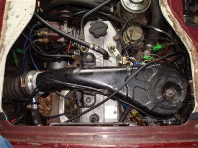

Hi, my Toyota 22r motor has problems idling since it was converted to run on LPG. Basically the engine tick over speed ranges from barely-running 500rpm to 1500rpm. This happens whether the engine in running on petrol or LPG. Also, there is a strange, intermittent sucking noise coming from the region of the carb - also since LPG conversion. Finally, on LPG the car stalls on downshifting whilst the clutch is down and backfires on braking. Is it the timing or do I need uprated HT leads and distributor to cope with LPG?

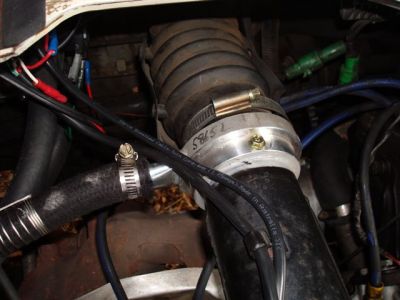

1) When I refer to tick over - I mean the idle speed of the engine (sorry, I'm British and live in Australia so the terminology is a little different!) The idle speed just seems to vary between 500-1500rpm without any apparent cause. 2) I believe the backfire is out of the tailpipe as I only really hear it when I'm passing a building so that the sound reflects back off it. 3) The regulator is just connected to the join between the pipe from the airbox and the thin metal housing that sits above the inlet manifold - it's not mounted directly onto the manifold at all? 4) Would changing the HT leads, distrubutor cap, rotor and spark plugs make a difference? 5) Thought you might like a picture of a koala as I don't think you get too many in the USA!
https://images.2carpros.com/forum/automotive_pictures/271873_DSC00299_2.jpg
Top of engine.
https://images.2carpros.com/forum/automotive_pictures/271873_DSC00300_2.jpg
LPG injection point into inlet hose.

WOW, a koala, I think I had one of those in my backyard last week. Ya right, I'm in Minnesota, USA. I was working with a guy from Auckland, New Zealand a couple nights ago. Anyway, on to your problem. You could go ahead and change HT parts, it can't hurt. You will usually notice a high voltage problem under a load and it doesn't take any more spark to fire LP than it does gas. Looking at your pictures, is the air cleaner well sealed? It's the vacuum of the engine that actuates the LP regulator. Any air leaks between the carb and the regulator will affect idle.
When the engine is running on LP, the only part of the carb it is using are the throttle plates and if the irratic idle idle occurs with both fuels, we have to look elsewhere. Try unplugging or blanking off the EGR valve and see what happens. In the interim, I'm going to do a little research.
