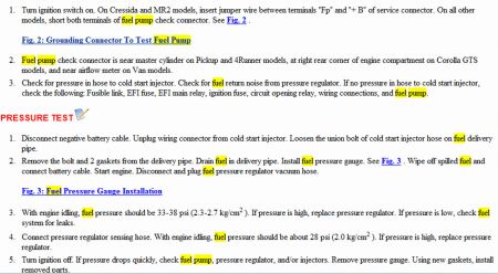

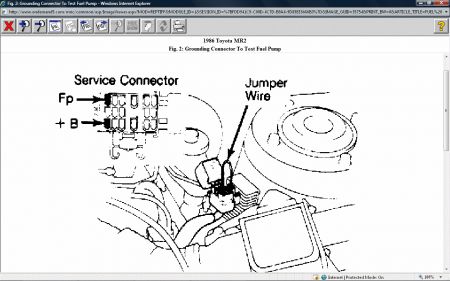

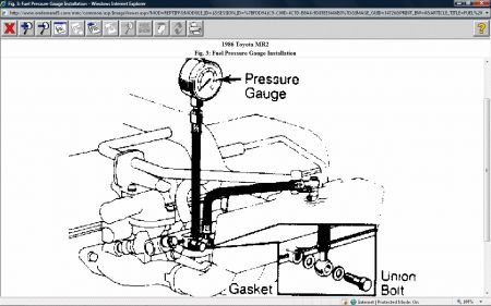

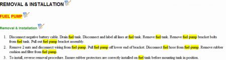

My husband has purchased this car, and he thinks the fuel pump is bad. He is going to try and fix it himself, Where exactly is it located?
Jun 30, 2008 at 5:41 AM
MERLIN2021
  • 17,250 POSTS
He may know all this but here's how to test and replace it, it's in the gas tank...follow the testing first!
