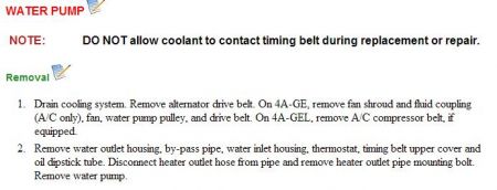

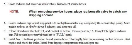

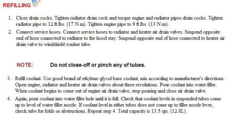

How do you replace the water pump on a 1985 MR2? Specifically how do you purge the air out of the hoses?
Thank you!
