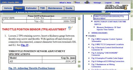

I am getting fuel, after replacing the EFI relay switch, fuel pump and filters. She now idles fine but when I put her in gear there is no power to even get out of the driveway. So that is the problem, she idles fine but in gear she is starving for fuel push the clutch back in and it returns to normal idle. That is why I was thinking injectors or mass air flow sensor, unless I am missing something???

Inspect and test the throttle position sensor-

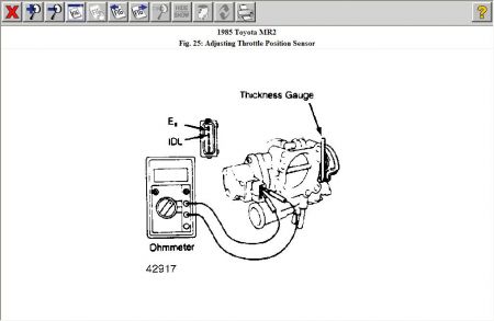

Resistance reading for the TPS, throttle fully closed .2 throttle fully open 4.65 indicates bad TPS?

Does anyone know if that is within specs?

Adjust the TPS
https://images.2carpros.com/forum/automotive_pictures/12900_mrtps1_1.jpg
https://images.2carpros.com/forum/automotive_pictures/12900_mrtps_1.jpg
