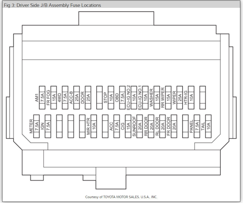

Cigarette lighter blows fuses when using cell phone charger. I can't find the fuse box for this.

The Cigarette fuse 15amp is in the left end of the dash driver side junction block.
Here is a guide to help you test it.
