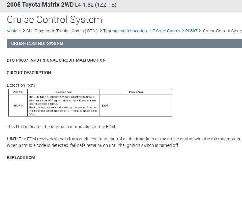

hi , Merry Christmas we have in my shop a toyota matrix 2005 in the dash board have check engine light on the machine said code p0607 please can you let me know what is the problem and located please thx

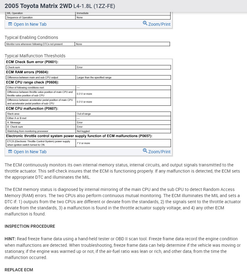

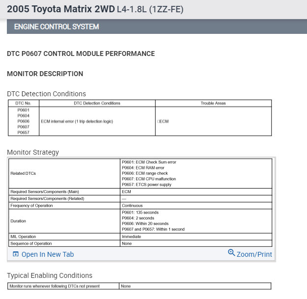

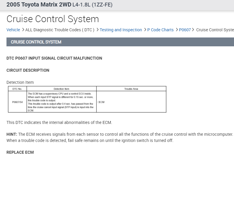

The code P0607 Input signal circuit malfunction. This is a cruise control code.
Typically gets triggered due to an issue with the ECM.
The ECM receives signals from each sensor to control all the functions of the cruise control with the microcomputer. When a trouble code is detected, fail safe remains on until the ignition switch is turned off.
What issue(s) are you experiencing?
Is the cruise control functional?
I have attached the trouble shooting steps below.
