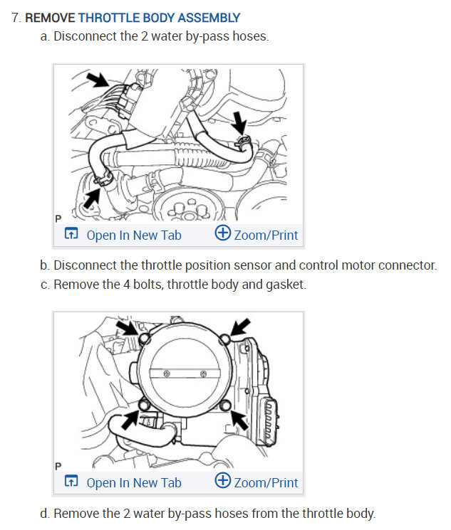

You might want to service the throttle body, here is how in this guide with image below to show you how on your engine:

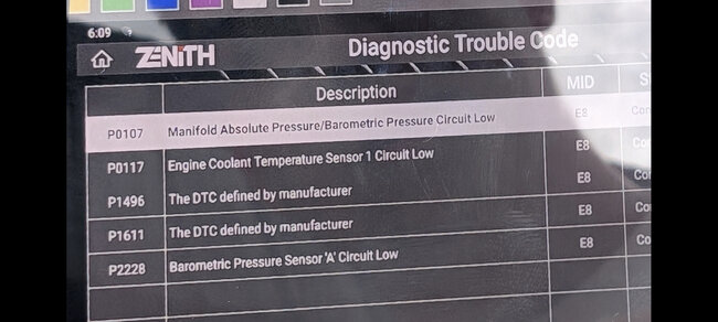

Hi, these are the errors that comes out of the computer:
p0107 manifold absolute pressure/barometer pressure circuit low
p0117 engine coolant temperature sensor1 circuit low
p1496 the dtc defined by manufacturer
(P1496 intake air temperature sensor 1 circuit low)
p1611 the dtc defined by manufacturer
(P1611 ECM/PCM processor/run pulse)
p2228 barometric sensor pressure 'A' circuit low
Also, when we pull out the battery terminal and plug it again, the car starts and when moving a few meters and we start to turn right, the car stalls then check engine and 4LO lights turn on.

Yep, it sounds like limp mode but with these codes it looks like the exhaust system might be clogged up, but I would try to replace the MAP sensor to see if things change. Clear the codes once the sensor has been changed. Also, service the throttle bore as well.

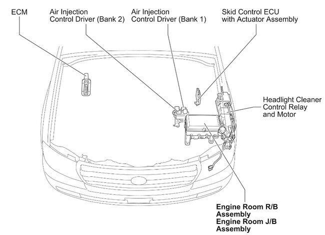

What we did was check the wires connecting to the PCM/ECU and found out some wires were loose, so we disconnected and reconnected again. So far used for a few hours and hasn't stalled yet. Will update if anything happens again.
