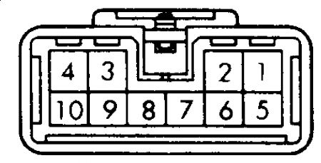

You might want to check ECM grounds too. One on right and left kick panels black/white wires and one on air intake chamber brown/black. IGNITION SWITCH Disconnect ignition switch connector. With ignition switch in specified position, check continuity between specified terminals of ignition switch connector. See IGNITION SWITCH CONTINUITY TEST table. See Fig. 4 . If continuity is not as specified, replace ignition switch. Page 1 of 1 STEERING COLUMN SWITCHES -1995 Toyota Land Cruiser

Check grounds - still no luck. It seems due to the consistent nature of the issue that a ground or issue with ignition switch would be more of an inconsistent problem. The problem is somehow heat related. After 10 minutes at higher speeds, starts to happen - almost like clock work. Any other suggestions.

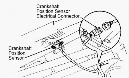

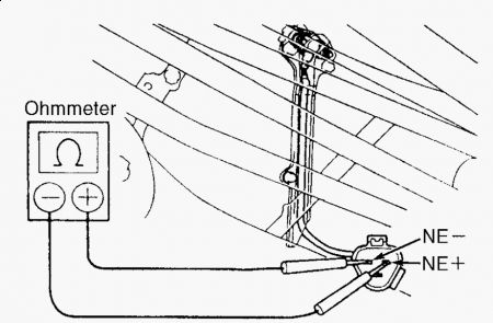

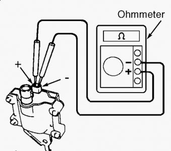

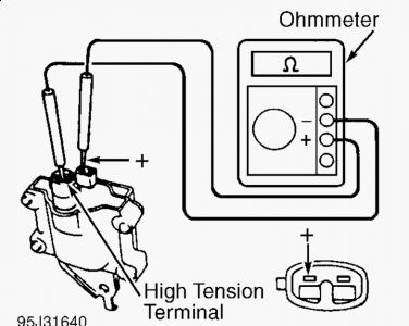

In the old days first thing we looked at when it was heat related was the coil, been done yet? Also check CKP, and CPS. when hot!
https://images.2carpros.com/forum/automotive_pictures/62217_CKPTOYOTA_1.jpg
https://images.2carpros.com/forum/automotive_pictures/62217_CKPTOYOTAB_1.jpg
https://images.2carpros.com/forum/automotive_pictures/62217_COILTOYa_1.jpg
https://images.2carpros.com/forum/automotive_pictures/62217_COILTOYB_1.jpg

Mar 26, 2009 at 6:56 AM
MPREVATT3
I don't think the coil has been replaced. Is there a way to check the coil or do i just need to replace it and hope? What is CKP and CPS? How do I check? Thanks.
