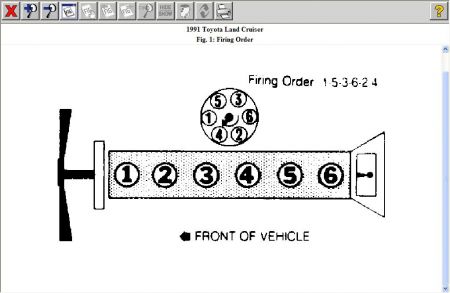

I was doing a tune up and I changed spark plugs and wires. One wire broke coming off and I mixed up my wires. I have the firing order and think I have the wires right but they still appear to be crossed. When I start the truck its rough and popping, what else do I need to do?

For a start reset the F/O see below
https://images.2carpros.com/forum/automotive_pictures/12900_landcruiser_1.jpg
