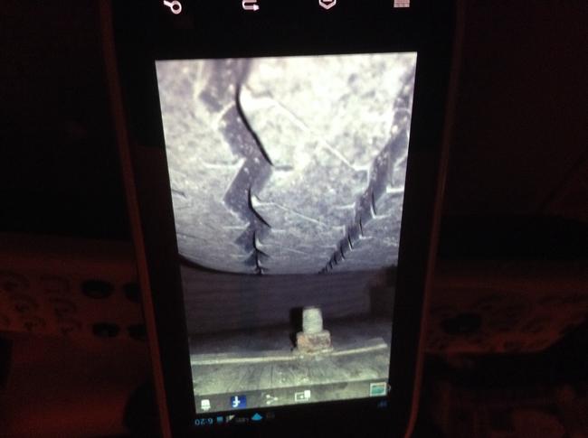

Bolt 1-2" above tire in wheel well. Do I dare tow anything? Cut it off at nut?

DOES YOUR AXLE HAVE A RUBBER BUMPER/ SNUFFER ABOVE IT?
IN OTHER WORDS WILL YOUR AXLE BOTTOM OUT ON THE BUMPER BEFORE THE WHEEL WOULD HIT THE BOLT?
CAN YOU REPLACE THE BOLT WITH A CARRIAGE BOLT, EXCEPT MAYBE INSERT IT IN THE OTHER DIRECTION?

You can turn the bolt around that should give you plenty of running clearance.
