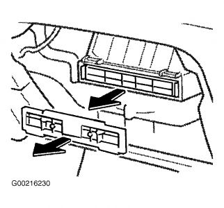

I live in the high desert of New Mexico ( approx 6.5 " of rain all year so far) and while the air conditioner works fine there is a foul musty odor only when the Vent is selected. Doesn't seem to make any difference if outside air or interior recirculation air is on. Is there a filter that can be changed or some kind of disinfectant used? Many thanks Don

There is a cabin filter right behind the glove box. as for disinfectant, I would use Ozium, it works great for killing odors like that
https://images.2carpros.com/forum/automotive_pictures/1639_toy_1.jpg
