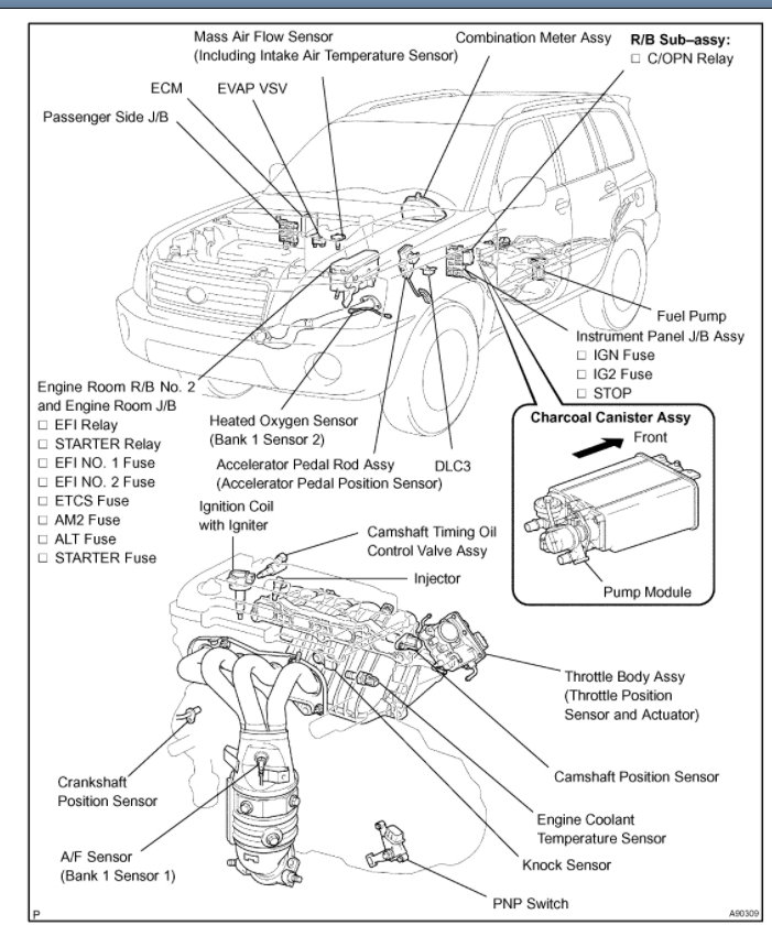

Getting a code indicating it needs replacing. Sensor is a Bosch Part#15984. The sensor is made with what I would call a heat shield around it that won`t allow a sensor socket to get to the sensor`s 7/8`s nut. Is there a special thin walled sensor socket available[img:54d40dee85]http://www.2carpros.com/forum/automotive_pictures/213950_IMG_0176_1.jpg[/img:54d40dee85] or did Toyota do this by design to force people to bring the car to a dealership because they have a special tool which is not available to the public ? Anyway I haven`t been able to find a sensor socket that will work in this application. They are all too thick walled. Thanks in advance.

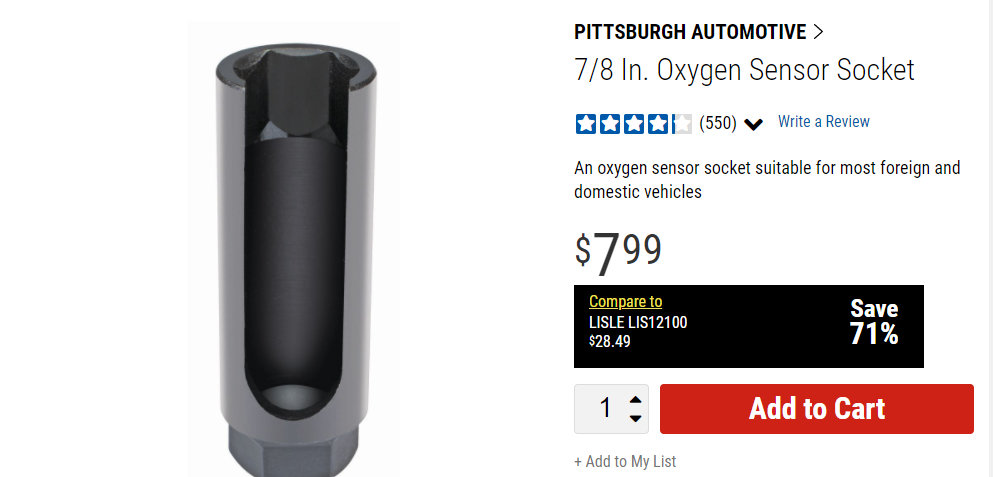

Yes, there is a socket that is made for this. Basically, you need to get the o2 sensor socket that will help with removing this.

Plus, below you will find the information about the sensor and socket which is just a common one that will work.
As you can see this is a thin wall socket that has a cut out of the side that will allow the wire to come out so that you don't have to cut the wires.
Please run through this info and let us know what questions you have.
