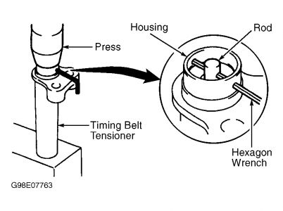

how do I loosen the tension pulley to instal a new engine drive belt?
Jan 3, 2009 at 7:46 AM
MHPAUTOS
  • 31,937 POSTS
Hi there, You must remove the tensioner and depress the piston, and secure it with a suitable pin to hod it in place, if there are any signs of oil leaking from the tensioner it must be replaced. mark (mhpautos)
