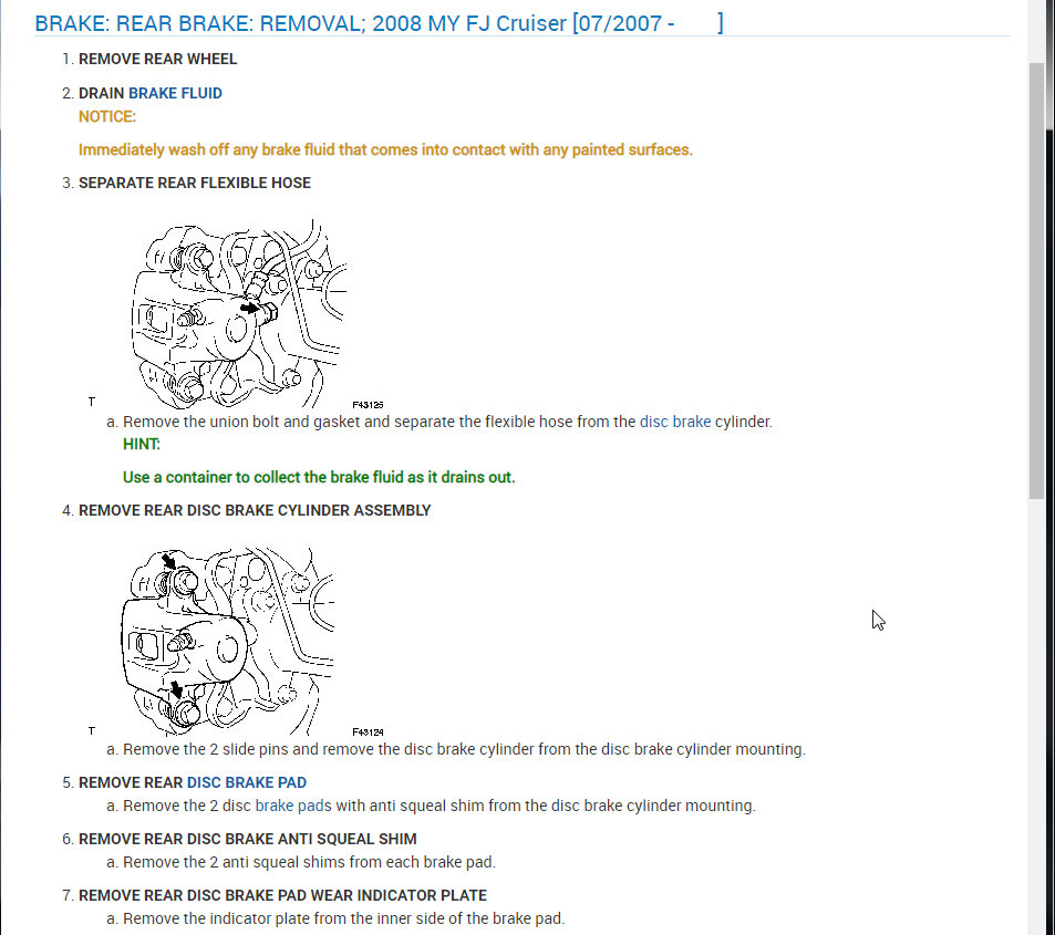

Sometimes in traffic when I stop for a red lite the rear brakes will grind.
Sunday, August 15th, 2010 AT 9:17 PM
MECHANIC
18,907 POSTS

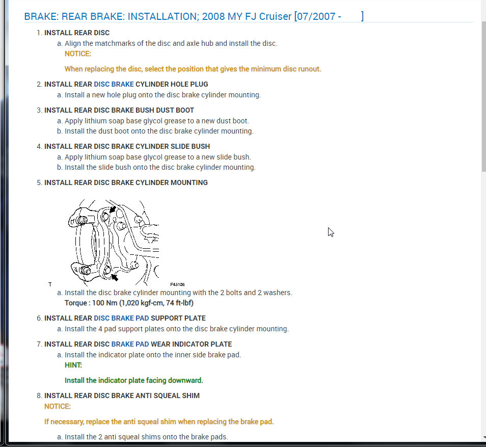

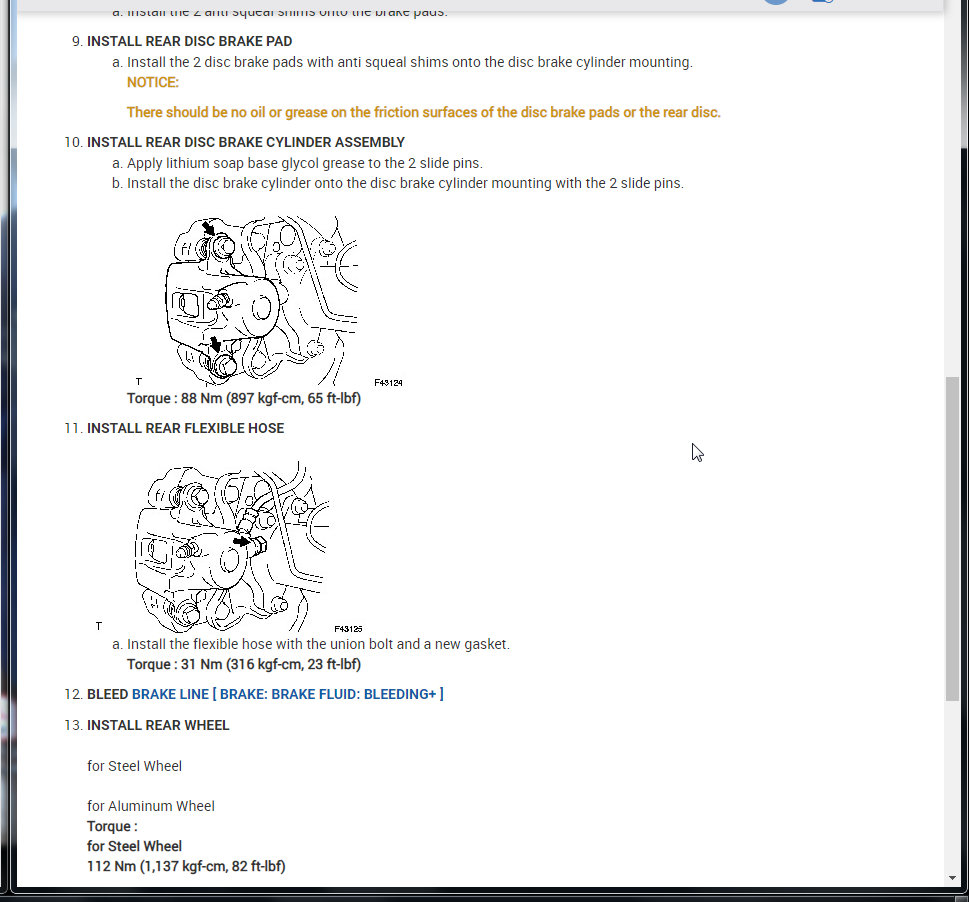

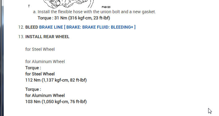

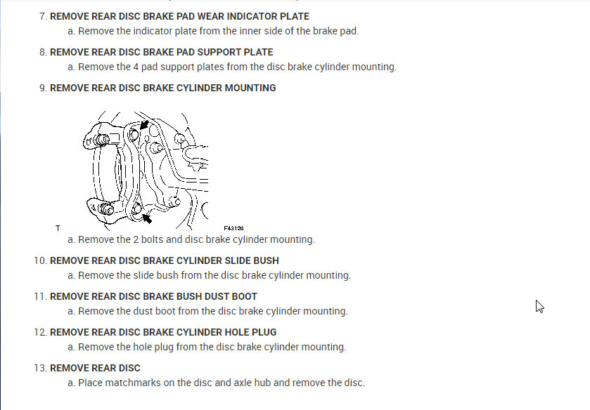

Here is a guide that will help with this information:
https://www.2carpros.com/articles/how-to-replace-rear-brake-pads-and-rotors
Please see the info when below on how to replace the brakes from the manual. Let us know if there are questions with this and we can go from there. Thanks
