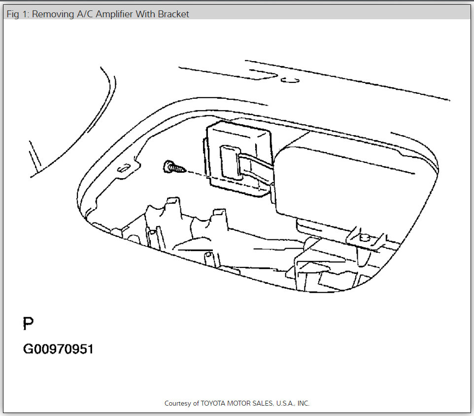

engine is on. turn A/C on. it blows cold for about 10-12 minutes, then it blows warm. If i turn the A/C off (car still running) and wait for about 10-15 minutes then turn it back on, it will blow cold. can you give me an idea as to what it might be before i take it to the dealer?
thanks, sue

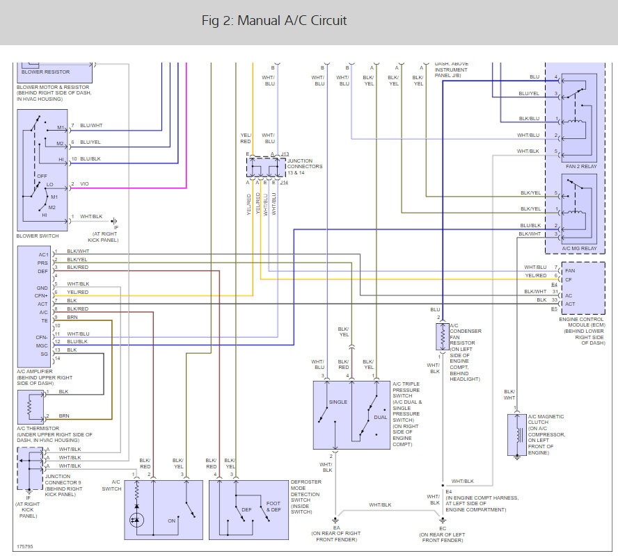

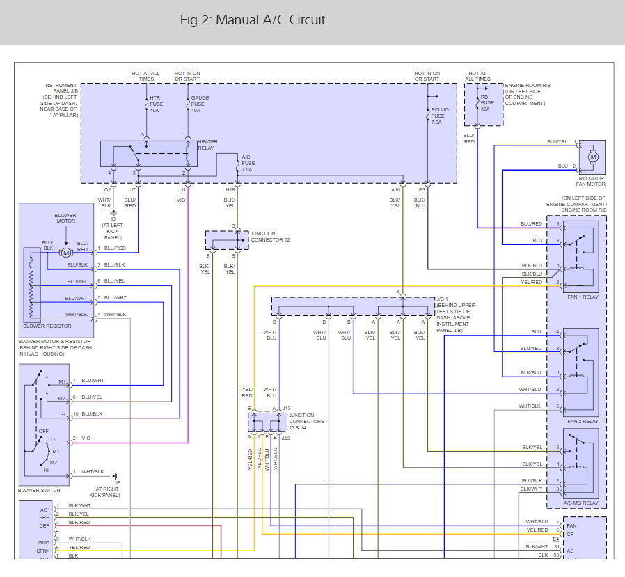

This sounds like you have an air conditioner amplifier that is not working right here are diagrams so you can see how the system works and the amplifier location.
Cheers
Jul 17, 2010 at 12:55 PM
SAINJEE1
You nailed it ! I had my car at the shop and they replaced the amp cost me $210.00
